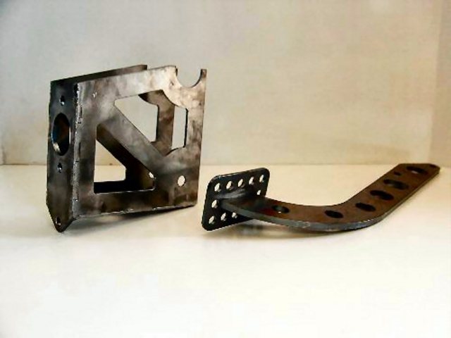

I would say anything thinner than 5mm is too thin because the pressure is seldom applied directly in line with the pedal blade if you actually think
about it. Just look at the wear on any rubber pedal pads.
I use 6mm plate for my laser-cut pedals, but cut some lightening holes in them which doesn't detract too much from their strength.
Cheers, Rorty.
