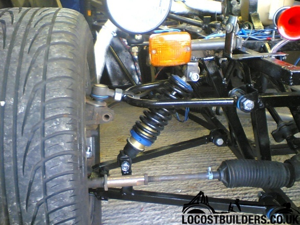

| posted on 8/5/05 at 06:52 PM |
on sierra hubs the top bit points in quite a lot i used MK top bones anyway, so dont blame me!!!
this pic looks like the bones on mine dont diverge enough, it an illusion
and again, im still missing that bolt!!!!
