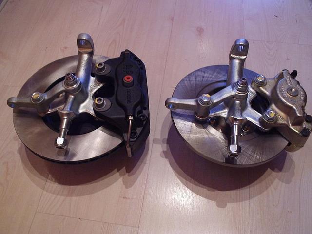

Mad Dave
| posted on 6/1/06 at 09:53 AM |
Don't Cateringvans use a GT6 upright? Good idea as nice and lightweight and designed for LSIS style front end.
These are what Caterham use. U2U me if you would like a contact name and number!?! They manufacture many classic car parts as well as some not so
classic parts.

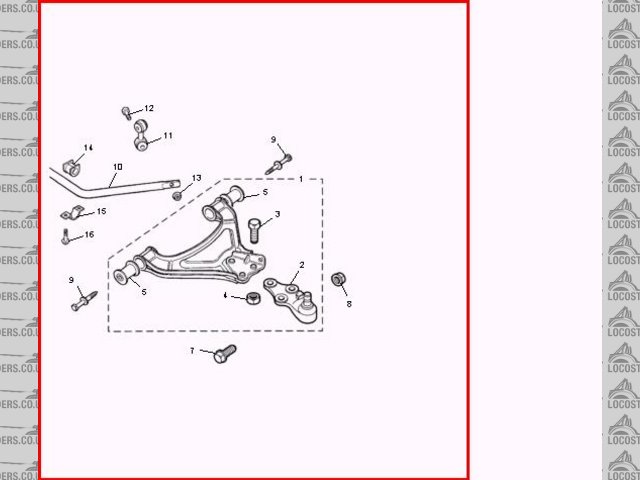

britishtrident
| posted on 6/1/06 at 10:35 AM |
MGTF front suspension

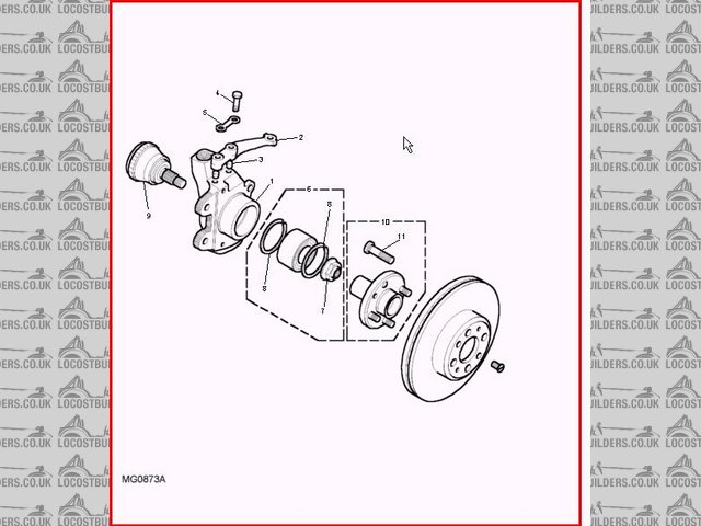

britishtrident
more MGTF

cymtriks
| posted on 7/1/06 at 11:22 PM |
If you want to go the front engine, rear drive route, I think that marina/moggy rear axles will suit.
Remember that for a midi, the metro bits will be fine, but the steering arm is at the rear of the hub, so book chassis layouts may be a little more
complicated.
If going midi, another set of metro fronts will do the trick
The picture of a TF suspension shows a separate bolt on steering arm. If the TF upright is a Metro one then the Metro steering arms should also be
detachable?
Could the originals be reversed?
If the MG/Metro and the Triumph uprights are so good why isn't everyone using them in preference to bodge modified Ford units?
Doesn't the Lotus Elise also use MGF/Metro stub axles in an alloy upright?
What is the geometry like on the Triumph/MG uprights? Srub radius with standard offset wheels? King pin angle?
