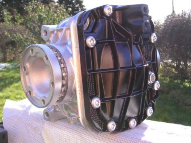

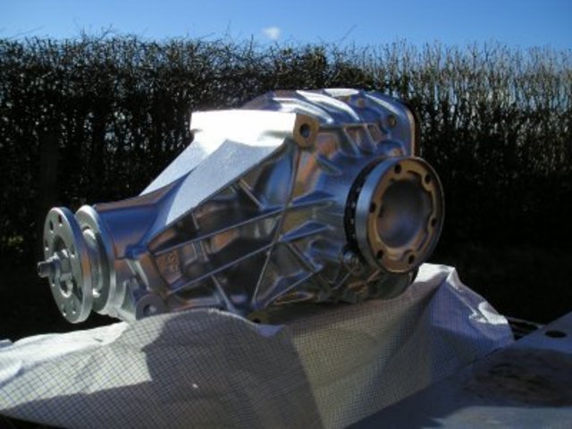

locoboy
| posted on 5/3/06 at 04:49 PM |
Pimp My Diff!
bit of a scrub and some paint and doesnt she come up nicely
  sml diff
  diff sml1

locoboy
| posted on 6/3/06 at 06:53 AM |
guys,
Its a 7.5 Cossie LSD, Flak you know your diffs!
Seriously all i did was use Gunk foam aerosol degreaser,
steam wash it at work
then yesterday morning give it a good session with the hand held wire brush and then using a jewelers screwdriver to scrape the oxidisation off in the
deep holes between the strengthening ribs.
2 coats of Wliko's own metal primer (spray)
then 2 coats of Plastikote metalic silver spray (up to 240deg C)
The back plate was done with the same primer and then using Plastikote Black super gloss as top coat.
The bolts and plug were done in the metalic silver.
All in all probably about 3 hours work. I had to replace the backplate anyway as it was cracked so thought i should make the effort whilst it was off
