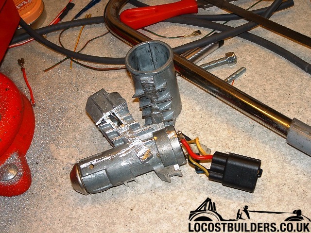

If its the same column as ours (think they are all the same) the top part with all the switch mounts just taps off see pic
  steering lock before
Pic looking towards end where wheel would be. After that, it can be machined smooth like ours now or some manufacturers will exchange it at a small
fee for one already machined. Will take a pic tomorrow if it helps.See pic HERE - after
cutting it off with hacksaw. Now machined smooth.
HTH Ed

I hacksawed mine off like that then filed the ribs off, you don't see it when the steering wheel is fitted. As Ed says, it just knocks off but
there's a bearing in there so it's easier to keep part of it.

some new pics in my archive of the finished thing here
and here . Be careful if you cut it off though as its
only thin ali.

Thx for the tips guys, took the hammer & then the saw to it this afternoon & hey presto... the job's a goodun!
