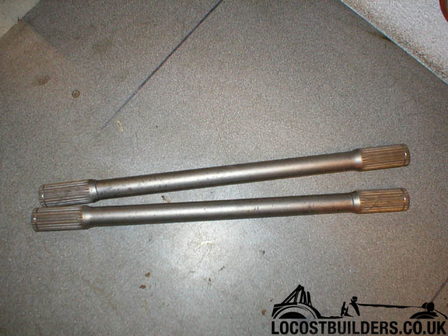

liam.mccaffrey
| posted on 24/5/06 at 10:05 PM |
from nats archive
http://www.locostbuilders.co.uk/upload/2shafts1.jpg
[Edited on 24/5/06 by liam.mccaffrey]

| posted on 24/5/06 at 10:18 PM |
cheers Liam!
(only one thing I will say is I can't guarantee he will have the tooling for that job, I know he has the stuff for all the ford splines but I
don't know about rover stuff)

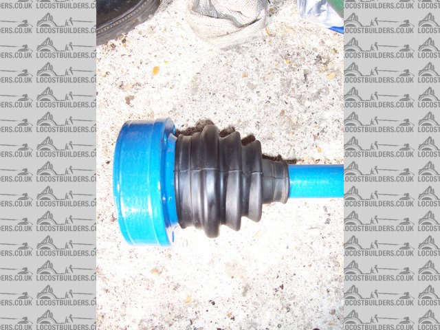

i did mine at home....
mine are sierra shafts but needed to change from push in.....to bolt on...so did the job at home no probs you need to check that the splines are the
same sizes if they are..you are in luck....wont cost ya much...
before and after pics of my cut`n`shut job as you so quaintly put it...
u2u me if you are interested in what i found and my dissasemble reasemble proceedures....its easy and safe and cost nothing....cant beat that!
VanHaydn
posted on 25/5/06 at 01:03 AM |
before and after
cut`n`shut home job
VanHaydn
posted on 25/5/06 at 01:04 AM |
other angle
same thing different shot
VanHaydn
| posted on 25/5/06 at 01:05 AM |
the other side
other side

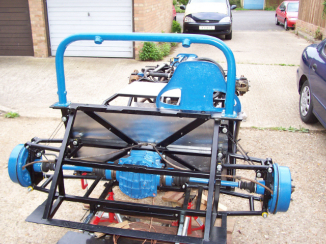

VanHaydn
posted on 25/5/06 at 01:06 AM |
on the car with lsd
finnished cut`n`shut jobbo....
