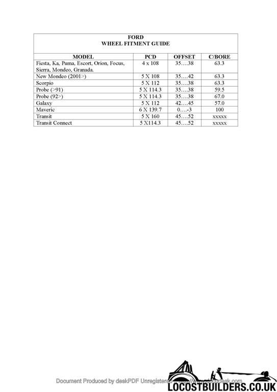

This might help you

Iv got 38 offset wheels on my locost. Fit a treat. They came from a fiesta.
