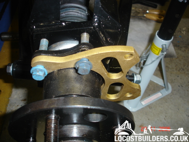

I've been wondering about this. I'm going to use disc brake adapter plates on my drum braked back end. Because I haven't got all the brake parts together yet, I have some trouble visualising it all but here's the problem I see.
The adapter plates are mounted on the outside of the hub carrier. Now supposing the plates are 8 mm thick, doesn't this mean the mounting points for the calipers are 8 mm offset to the outside of the car as compared to the original setup? Meaning they will be too close to the discs and not fit together?

I've always thought that the brake disc adaptor plate went between the bearing carrier and the axle, not outboard of it as in the picture.

The adapter plate only uses three holes to bolt to the bearing carrier, no all four bolts. Therefor if I put it between the bearing carrier and the upright or axle, there will be a gap between the bearing carrier and upright where the fourth bolt goes trough. That's why I assumed it went on the outside.
By the way, this doesn't change the basics of the original question. If the plate is put behind the bearing carrier, wouldn't that put the caliper too far to the inside of the car?

Yes, but then you can use spacers to position the caliper in the right place, the sierra part for mounting disc is included in the bearing housing, so the mounting face for the caliper is the back edge of the bracket in your picture.
