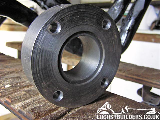

Billbro
posted on 8/2/07 at 03:08 PM |
Spacer
This one is heavy, I would have prefered it made from alloy but since it was free.
Billbro
posted on 8/2/07 at 03:14 PM |
spacer
How do you show a picture? It's in my photo archive.

westcost1
posted on 8/2/07 at 03:53 PM |
Thanks looks good maybe ill get an ally one made up. I was just thinking that the original sierra prop had a big fly wheel thing on it so maybe the
extra weight would be good?
