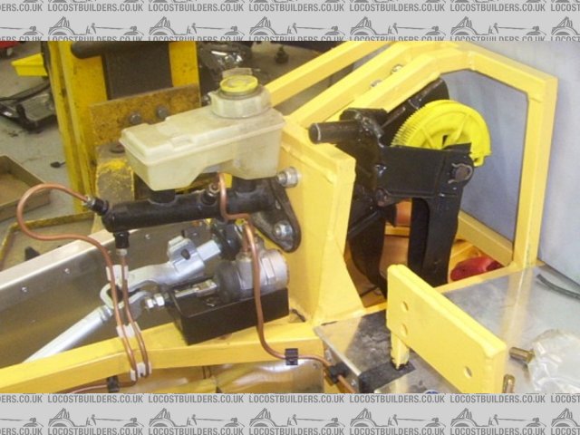

If you use the pedal pushrod and link this to directly to the master cylinder, and chuck the entire servo, comlete with the pushrod, even more wonderful things happen, you get a MAC!
This works with the drawn steel master cylinder, may work with the cast ones. Rescued attachment BrakePedals&Cylinder.JPG
