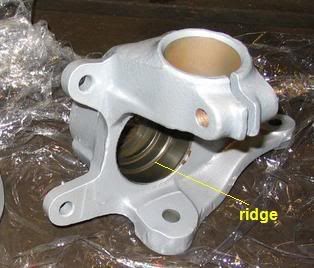

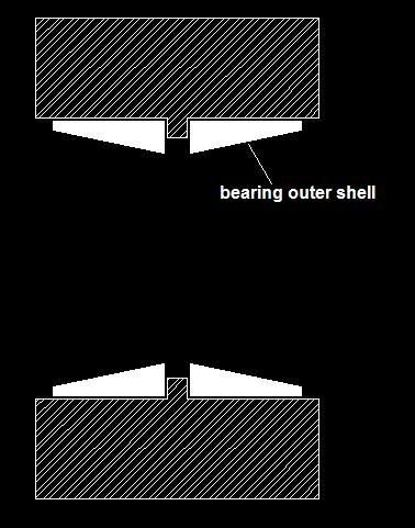

mcerd1
| posted on 22/2/07 at 12:59 PM |
Yep, knock them out from the centre with a drift/ punch - it shouldn't be to tight
here's a pic of the hub carrier with them removed:
and a quick sketch of the x-section
Minicooper
| posted on 22/2/07 at 01:05 PM |
Thanks everyone,
I've done other wheelbearings in the past, they have started to move fairly easily, but these seem very tight. I have soaked the carriers in
WD40 overnight, it may or may not help but I'll give it another go
