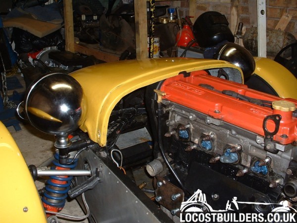

Just took the crossflow out of mine today and have put the Zetec in place to see how it fits.I have 5.5 inches under the chassius rails and the sump has 4 inches clearance with the wishbones level as it was with the crossflow.I chopped an inch off of an escort sump which makes it roughly 145mm deep..
I now have to work out how to make the nosecone fit as the front of the cam cover is about 1.5 inches to high to fit under the lowline nose cone that I have.
Im thinking of cutting a section out and makeing a new bonnet with a scoop that extends forward over the nosecone, im going to measure up tommorow and decide.

i must have low profile bodywork then,had to cut the nose cone to get it over the cam cover
