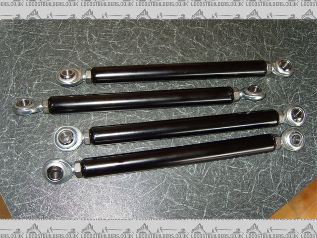

saved a few quid, my trailing arms.
Got bored on wednesday, and decided to make up some rose jointed(1/2" unf) trailing arms for my locost build. The first one came out pretty neat,
so carried on with the others.
- well chuffed .
They are 315mm between centers, upto +375mm possible.

tube length
The tubes are 25.4mm (imperial in reality)x 3mm.
The lengths I cut were around 245-255mm and a welded in threaded bung (abouts 3-4mm potruding out the end) with the rose joints threaded in c/c =
315mm ish. With room to shorten or lengthen.

Don't like to take the shine of what is a lovely job but its not a good idea to rose joint both ends, best to have a bush at one end.

ACEsportscars sell the same trailing arms threaded for rosejoints both ends.
I see where you're comming from though..
But for me this has saved me a few £as I had lots of rose joints around, saves me buying bushes and jigging them.
Please excuse my ignorance, if its not for the case where all four arms could unscrew without you noticing! why?
