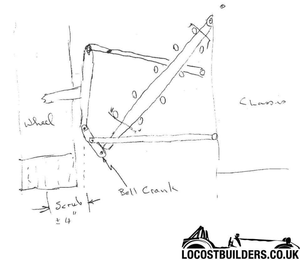

I had the pleasure of seeing an original 7 at a racing workshop yesterday - unfortunately didn't have my camera so will return next week to take
some photo's and investigate further.
I was thinking about the front suspension setup when it suddenly struck me that there was something very peculiar about it.
1 - the lower A-arm seems to terminate in a "bell-crank" with the shock mounted on one end and the upright on the other - I think there is
some kind of stop to prevent it going "over-center" but it seems to have significant benefits in full droop allowing a lot more droop than
the shock length would normally allow thus allowing more shock movement to be used on bump and hence softer springs.
2 - the above arrangement also gives reducing scrub on bump or roll - the setup has huge scrub at ride height passing well inside the inner wheel
edge.
3 - the upper arm is a single arm with the roll bar adding lateral support - looks like a lower cortina or mark 1 Escort arm.
The arrangement puts very little strain on the lower arms and their size is minimal.
I will definitely investigate further - anybody know if I've got the system right or did I misunderstand what was happening.

I don't know what you have seen.
But the Caterham and Donkervoort have still the same (and a little .....)
I don't think it's different
Only the upper arm has the anti-roll bar in the upper arm, making the "A" complete.
The lower strut mounting is lowered to fit.
It sure looks quit nice, but no complicated thinking. Look here:
  owners manual series 2,3,4

The uprights are standard motor company and were found on spitfires and heralds. They have trunnions on the bottom and a stub axle that take rwd
escort front end. early one had only one link at the top connected to the anti roll bar.

OK - Thanks for the feedback - I obviously misunderstood some of it - obviously from the manual that "bell-crank" is fixed not
pivoting.
