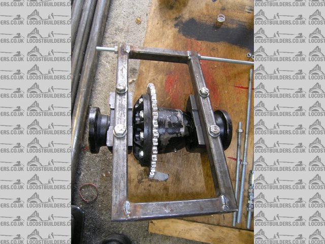

I made the diff carrier frame this morning.
That bit of studding will be the pivot point at the bottom and I will have to make a couple of arced channel guides at the top and weld on some
adjusters etc.
I am having problems undoing the nylocs on the diff as they fit snug into a recess and the bolt is tight against the housing. They are as tight as
hell and my impact sockets won't fit!
Any such thing as a thin impact socket?
Once I get them off, I will replace them with cap heads.
  chain diff carrier

nitram38
| posted on 9/6/07 at 04:29 PM |
I sorted the sprocket out!
Halfords do a 17mm impact socket that is narrow for getting alloy wheel nuts off.
It is made by laser and is £7.99
  new sprocket
