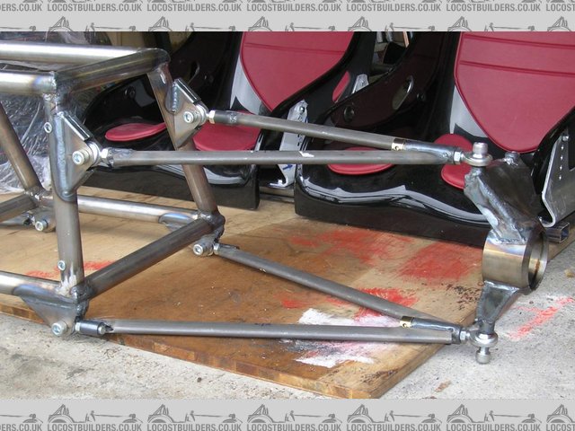

posted on 11/7/07 at 08:01 PM Reply With Quote
kyanther
posted on 11/7/07 at 08:12 PM Reply With Quote
thanks
do they all need to be that way around, i was thinking rose to replace top and bottom ball joints, didnt know if roses were up to taking weight so was thinking mounting a rose bearing on lower plate.
you see im looking at fabricating the uprights so would make them rose friendly instead of conversion!
Or am i talking ....... well rubish?
ps you got me thinking about internal mounts now, was going to leave them as bushes!..... thanks!!!

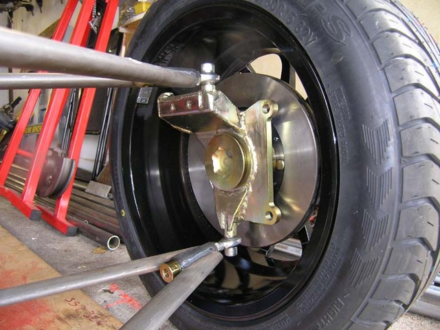

front upright on bones

Nitram38 - Are you sure you wouldn't be better off with ball joints on those uprights?
Rod ends are designed for the transmission of loads where the loads are colinear to the axis of the stud, i.e., rod ends are the load points in a ‘two-force’ body that push and pull along the axis of the rod end stud. Rod ends in that orientation (rotated 90 degrees) will be severely compromised and a ball joint would have more bearing area in the vertical plane imo. I'm willing to be proved wrong though

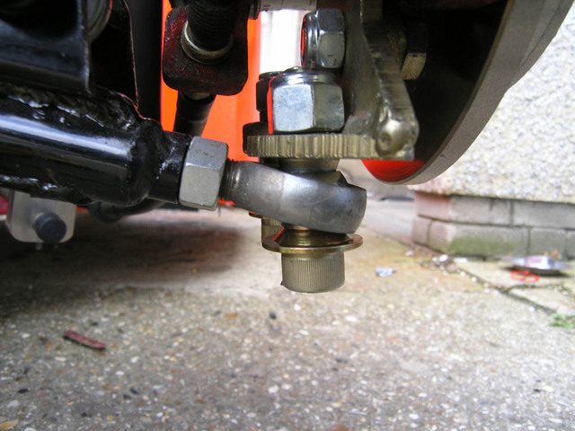

nitram38
posted on 12/7/07 at 04:51 AM Reply With Quote
I have covered this loads of times before in posts that are years old.
Have a look at race cars. Many have rose joints this way around. My F1-2 has them this way around and so far 1400 miles and no problems. 7 ball joints were designed for a car weighing around 1200 kg originally. My car will be around 500kg.
The photos show the car in the building stages so the bolts do not have the washers on that act as a safe guard.
The washers are no ordinary ones either. I use them on the F1-2 and they come from pegasus racing in the U.S.
Here is a photo of the F1-2, a bit big and before anyone comments, the angle of the wishbone is caused by the car being off the floor and not set up.
Front bottom rod end on Ariel Atom and it doesn't even have a safety washer!
My bolts are drilled for lockwire and I will also be putting a grubscrew in the upright.
[Edited on 12/7/2007 by nitram38]

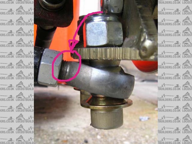

3. Failure of the ball region is not what I would worry about, normally where these joints fail is at the root of the threaded section (circled in picture below).
4. The picture of the Vortex shows a captured spherical bearing as the bearing for the lower end of the upright. This is a far superior solution to using a rod end in bending. As the bending loads are taken in the welded structure of the bottom 'A' arm rather than through the threaded section of the rod end. Rescued attachment RodEnd.jpg
