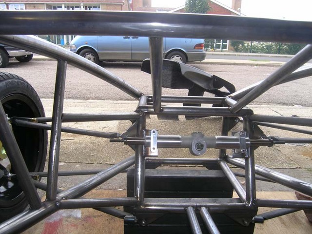

The advantages of your own rack are:
1.) You can chose the pivot points so they line up with your wishbone pivots and prevent bump steer. (My rack is inline with the top wishbone and
pivots match the inboard bolt centres).
2.) You can chose your own ratio (mine is 1 turn lock to lock)

Only twitchy if your castor is wrong.
If you put the right amount of castor in your set up, then driving with a one turn rack means that driving out of corners is a breeze.
You don't have to take your hands off the wheel unless you need to change gear, which is the correct way to drive, plus no crossed arms
either.
With good castor the car also drives straight and with the turn ratio, you only have to think about changing lanes on a motorway and it is done!
The F1-2 has a 1 1/4 turn and has brilliant feedback through the steering.
The only problem is if you try manouvering in a tight space without the car moving, but you soon get used to this and start turning while you are
still rolling.

The reason I have gone for a centre rack is for the steering safety offset as the MotaLeira will be RHD
On the F1-2 I had a centre rack because of the single centre seat, but you can just see two UJ's which give angle changes and was acceptable for
sva.
