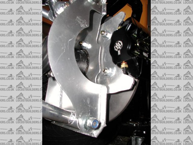

bigrich
| posted on 10/2/08 at 07:49 PM |
the siera stuff is the easiest choice as it bolts staight on then there are the aftermarket calipers like wilwood or high spec etc which genrally fit
with additional brakets etc
I have wilwoods in my car which use additional brackets but are fairly easy to install and lok geat plus save a good chunk of wieght
picture is when i was initialy fitting for spacer sizes etc
