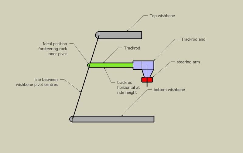

It's all to do with the optimum position for the inner pivots of the steering rack, the pivot should lie on a line between the top and bottom pivots and as close as posible to horizontal at normal ride height
A bit like this.

Dont know the Sierra dimensions but if they're too far out (or in) you get the dreaded bump steer.
Bump Steer
Chris
