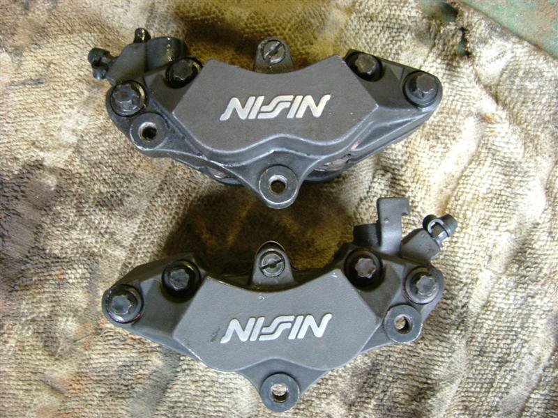

I'm fed up of the crappy brakes on my Autograss racer so i've invested in a shiny pair of NISSIN s of a blade.

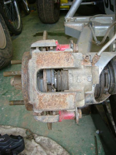

Question is how best to mount them on my trailing arms, the current calipers (fiesta?) are mounted thus:
So my plan is to remove the old calipers and make up spacers as above (red bits) and lugs to get them somewhere near.
Then plumb them in and fit them over the discs whilst an assistant holds the brakes on hence clamping the calipers on square.
Then just tack and then weld with brake pressure still applied to stop them from warping and moving the alignment.
Any better methods people have used or any problems you can see with this method?

They are tried and tested on Autograss cars, i've spoken to many people who have them fitted on the rears and fronts of Class 9's and
10's and are very happy with them.
They are a 4 pot caliper.
Couldn't be any worse than they are currently anyway.

They've already been machined, I had a check today and the calipers fit quite nicely around the disc.
I just need to sort out the fittings now as I have a quick look and an M10x1.0 starts off in them but not very far, looking on the net most NISSIN
stuff seems to be M10x1.25 so i may have to source a banjo and bolt in that size to try.
2.0 XE on GSXR TBs and Megasquirt

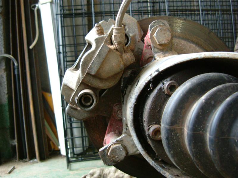

| posted on 31/8/08 at 08:10 AM |
hi
is there something wrong with you current calipers as in the first piccy it looks like the pads are not in line which wouldnt be good for braking
cheers
colin
GregSL75
| posted on 31/8/08 at 09:01 AM |
They do look a bit off in the picture, i'm not sure what's going on there. They were fine last weekend when I had them out to check, the
problem is the other side really where the lugs had got bent and the pads weren't contacting across the full area and so the harder you pressed
it was just flexing the bracket.
I straightened the brackets, but the pads had worn on an angle so the problem was worse! Hence I've got fed up and decided to start again.
That's why i'm anxious to get these ones right when I mount them up.

britishtrident
| posted on 3/9/08 at 07:44 PM |
quote: Originally posted by cjtheman
hi
cheers
colin
Well spotted it looks like the the caliper brackets are not true to the disk ie the pads are being presented at a slight angle to the disc surface
--- that gives a very spongey pedal.
