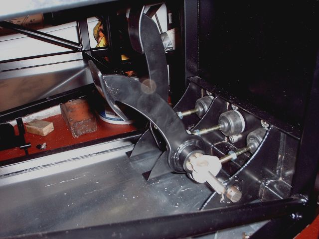

Slightly modified Sierra pedals in situ, they feel really comfortable. The accelerator pedal (not shown) is equally spaced but 1 1/4 lower to make
heel and toe nice and slick
