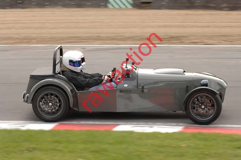

Hi Chaps,
I have decoded that I want to get somethign a bit more capable upfront on my R1 Indy.
From a previous topic, it looks like I have standard 1.6 Sierra brakes. What I now want to know is, will any Sierra braking system bolt onto these
uprights?
My Clio V6 use to Run AP's and Vented disks with RBF600 fluid and REdstuffs for day time use.
The only option I can find currently is a Wilwood "donor" kit that uses solid disks???
So, any other options available? What do the track only boys use.
pics I have of the current set up.

Plenty room there to fit bigger discs and keep the calipers. from memory if you fit cosworth 280mm discs the offset is such that you can extend the
caliper mounting with a lump of 10mm alloy plate - makes for a cheap job and upgrades your brakes by 20% or so.
Remember to upgrade rear brakes also. not too much though or the first time you brake hard you will swop ends

With the weight of your car you don't need/want vented discs. They'll just add weight. You won't get the heat into the pads.
If you want to upgrade do it to save weight or for the "bling factor" and the Wilwoods fit the bill nicely.

my pedal lost a lot of feel on my last track day nearer to the end of the sessions.
mentally, I have little faith in them, the rears look so much bigger and running 15's means that my unsprung weight is higher than what is
achievble.
My argument to my friend about vented disks was wont they "loose" any built up heat quicker and then that actually work as a loss?
I want a bit more upfront bite, rather than require a huge stab on the brakes everytime. i hate to say it, but i do not trust them as much as i trust
say the R88 tyres, the power delivery or balance of the car
