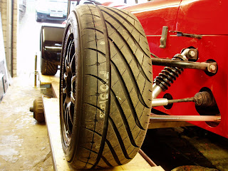

Coozer has just fitted the Parada Spec 2s and they look well worth a go I think. I used to like the A539s and these look like a small step from these delisted tyres in the direction of the trackday specials:
I've long been a fan of the Yoko A539's on hatches and my (Pinto) Indy - sadly they're no longer available.
I need to replace my fronts too and will be fitting Parada's as above.
