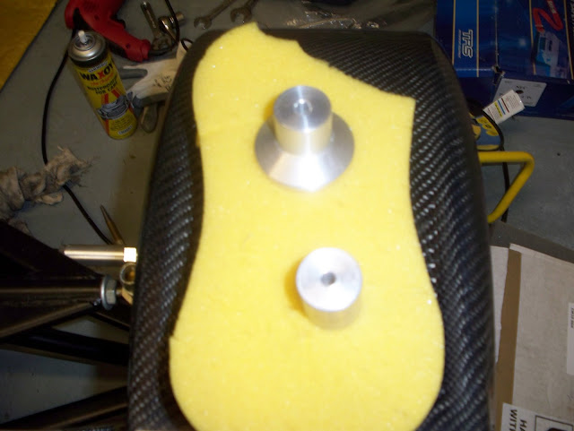

I had these turned (top one) for what's now Dan Mason's Vortx:
