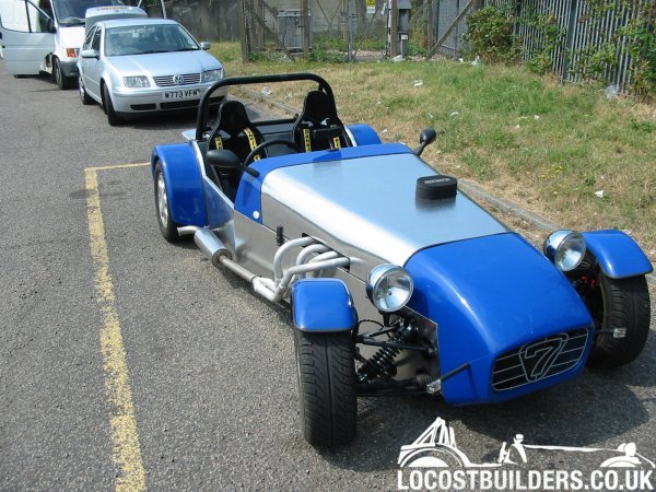

iiyama
| posted on 27/3/09 at 12:01 PM |
Not sure the mountings are to clear from this pic although it may help?
If its broke, fix it. If it aint broke, take it apart and find out how it works!
James
| posted on 27/3/09 at 12:18 PM |
Best pic I can find of mine is here:
http://www.locostbuilders.co.uk/upload/4test_at_the_centre.jpg
It's a tube welded between the rollbar uprights. (at correct height for the seats/seatbelt mountings height IIRC about 100mm).
I drilled 4 holes through the tube and welded 4 tubes through it that had 12mm holes through them. The 4 tubes were set at the centres of the seatbelt
holes.
I didn't use welded nuts as although they're cool if your seatbelts are fitted with normal bolts, if you use 'eyes' then the
threads need to be set so the eyes are in the correct orientation.
HTH,
James
- Muhammad Ali
