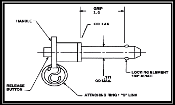

andkilde
posted on 29/5/09 at 12:45 AM Reply With Quote
If you had your seat mounts set up in double shear pip pins would do the trick.
stevegough
posted on 29/5/09 at 07:56 AM Reply With Quote
That diagram reminds me of something? Whatever can it be? I'm not going to say its on the tip of my tongue!
