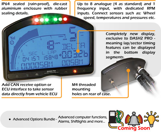

jeffw
| posted on 2/9/13 at 12:53 PM |
What you need (as discussed) is one of these bad boys
http://www.race-technology.com/dash2_pro_2_31358.html
Also the Dash2 Pro can link to a CAN interface which I assume your M3 ECU has(?)

Jeff - yup, that is the racetech option I'm considering. The m3 evo came out around the time ODBII was being standardised so that side of things
is a bit ropey, I suspect wiring in sensors manually might be less painful. I guess Racetech may have more info on that though.
v8kid - interesting idea but not sure I fancy it. Wiring in sensors would be tricky and I doubt it would be very readable in sunlight. Plus it would
get shaken to bits pretty quickly.

| posted on 2/9/13 at 07:34 PM |
No doubt the RT dash looks better. Doesn't mean it is better though...
One thing I noticed is that the RT doesn't have many data channels as standard (four, which you basically have to use up to cover oil temp /
pressure, coolant temp and fuel level), so you can't log e.g. throttle position, brakes, steering angle for example.
Jeff, did you have to add more data channels with an add-on, or did you use an additional data logger? Or neither? Can't remember if your setup
is based on the dash2 or dash2 pro?

| posted on 2/9/13 at 07:40 PM |
With the DL1, it has 10 analogue inputs.
I assumed you were talking about a Dash2 and DL1 to be honest.

| posted on 2/9/13 at 07:42 PM |
Mine is a Dash2 with the ECU cable for an Omex. The ECU sees most of the sensors and hence the Dash does. I did have a DL1 datalogger on the car but
I replaced that with a Video4 system. The DL1 has 8 data channels which can be used in addition to the standard 4 on the Dash2.

| posted on 3/9/13 at 11:34 AM |
Interesting, thanks for the comments all.
RT Dash2Pro seems quite good in terms of features. I especially like the ability to use the shift lights to show lap time compared to previous best
(e.g. green for faster, red for slower), this would work well for me as I'd have it centrally mounted with my existing shift lights in my eye
line (not enough space to see the dash behind my steering wheel). Ability to use existing sensors looks better than the ETB too.
Downside is that to get a sufficient number of data logging channels you need to spend on an add-on for 4 more channels, or ideally a separate data
logger to get 8 more, I think they've under-spec'd the dash2pro here. It is also more expensive...
