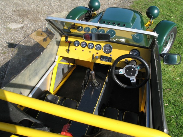

peter030371
| posted on 21/11/14 at 02:24 PM |
How many switches are you talking about and what sort?
Is you wheel fixed or QR?
On my old Striker with a QR wheel I mounted the buttons in holes on the spokes (two green switches for indicators and two black one for the horn and
one for main beam see picture below) and then wired them with a curly cord to an XLR style connector on the dash. The switches I used were low current
so all they did was switch a relay behind the dash. It worked with no problems for the 18 years I owned the car and I assume it still works
  Wheel
For my new build I have more switches so I have made this plate up to sandwhich between the steering wheel and QR adapter. Ignore the bit at the
bottom, I was going to add an RF link but scrapped that idea.
  wheel buttons
My new QR adapter has 10 electrical connections built in so the curly cord will be hidden behind the dash where it comes out of the steering column
All 8 buttons will still switch through relays though to keep things safe.

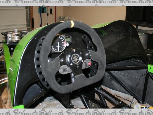

SpencerP
| posted on 21/11/14 at 05:04 PM |
I did similar, sandwich plate for curly wire.
Turn signal buttons on spokes.
Added CF plate to add switches for engine kill, start button, and headlamp main / flash.
[img]
  Steering wheel controls
[/img]
rodgling
| posted on 21/11/14 at 05:08 PM |
Why do you have stuff like engine kill and start button on the wheel - after all, you're not going to be pressing these very often?
SpencerP
| posted on 21/11/14 at 05:13 PM |
I just wanted a clean dash.
No ignition switch, use a RFID reader so swipe my "key" over a certain part of the dash for on/off.
Also when you are strapped in reaching the dash was difficult for me.
Finally I did it just because I could!
