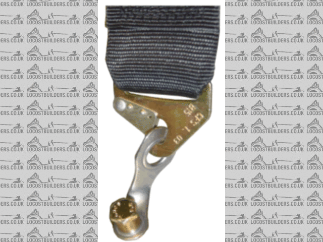

I have a set of 6-point harnesses with snap-in fixings in a Se7en..
Currently each of my lap-belts shares an eyelet-bolt with the corresponding side crotch-strap.
Apparently not ideal according to some sources, but I'm struggling to get a suitable lower-rear mounting for the crotch straps.
I have a further problem though which I was looking for a steer on. Once fitted, I can't move the seats forward due to the lap-belt adjuster
getting stuck between the seat-side and the interior panel.
So, I was wondering if I could use something like the bracket in this pic to extend the lap-belts, but instead of the hex-bolt pictured, I'd
retain the eyelet-bolt to attach the crotch-strap to.
Am I pushing my luck?
If it's a go-er, then what thickness of plate would you recommend for making the extension-bracket with (bearing in mind that I will need to
retain sufficient thread engagement for the eyelet-bolt).?

I would suggest that you have the wrong belts. You need a set which adjusts from the buckle (ie pull away from the buckle) and not pull up from the
mount.
I would also suggest changing belts would be safer than what you have suggest. Schroth (and others) do the correct belts for a Seven.

I've always preferred 'pull-up' lap-belts in a Seven due to the lack of space.
The bracket in the pic is a Schroth part designed for the purpose described. I'd use it and not give it a second thought if I could secure the
crotch-straps separately on a lower-rear chassis cross-member.
My only real concern was securing such a bracket under an eyelet bolt.

I think this is what you are looking for. See P39
http://www.schrothracing.com/docs/Co...structions.pdf

My crotch straps are connected to the floor under the seat with the normal eyebolts and a spreader plate under the floor. Given the limitation of a
Seven type car this was the best we could come up with while matching the Schroth requirements above.

Cheers guys... I've ordered a set of pull-downs to keep things simple. Will see how I get on with them.
