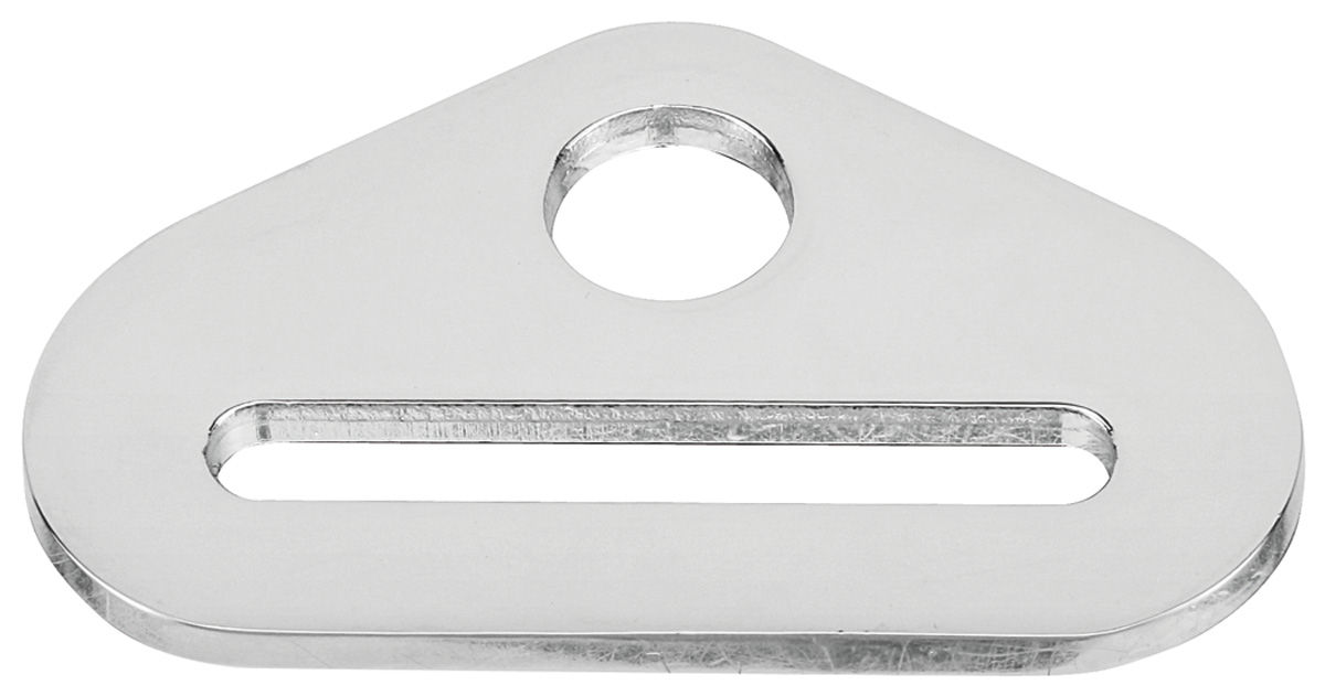

One solution is to fabricate a mounting plate with two slots - one for each belt and one hole for the mounting bolt.
Make sure to radius all corners touching the belts or make gromments with rubber hose.
HTH.
ETA:
Picture this, with two slots and only one round hole.
https://www.opgi.com/common/CH28535-lrg.jpg
HTH.
AA
