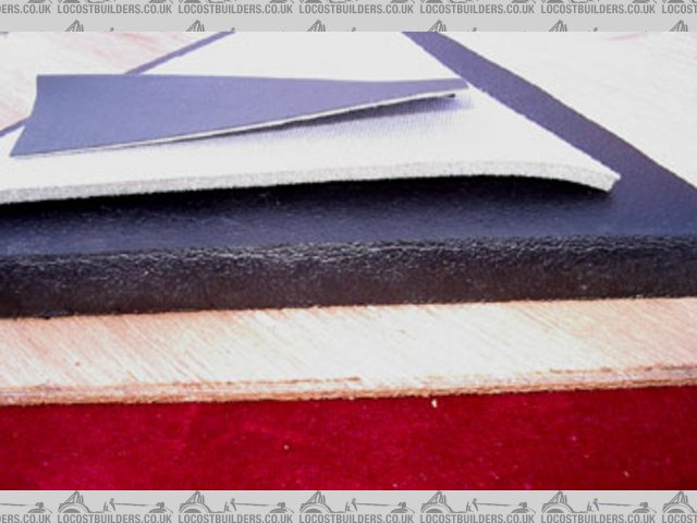

Hi
How about the foam rubber garden centres sell as kneeling pads.
I got some from a removal man. they use it to put between the
items of furniture in the lorry. It's about 15 mm thick.
I used it for my interior panels and dash.
It's the black layer between plywood and the vinyl in the piccy.
