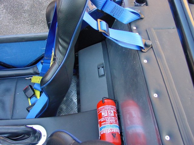

I got there before you with the Metro glove box idea (just one side, though)!
RazMan
| posted on 15/4/06 at 10:28 PM |
Humbug - I think it was your post a few months back that gave me the idea! They are just the right shape to fit in the dead area.
