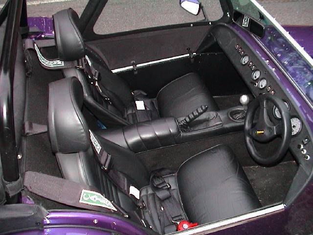

has anyone found a comprehensive site about car upholstery, as i'd prefer to do all the trimmming myself, my problem is the cover for the
transmition tunnel i am trying to recreate a panneled effect like below, any help would be great!

From what I can see from the pic, if its along the top of the tran tunnel, its look like the leather has been folded over several times (or have I
just stated something obvious?? Damn cider)
From experience, work out the shape you want and add or remove foam to recreate the shape, pull it taught and using either a strong adhesive
(bostic's great for this work) or, if using wood, staple gun the material down. To get the rib effect you might need to glue a fold into the
material first then pull it slightly tighter than the rest.
