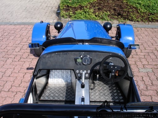

| posted on 10/4/08 at 11:43 AM |
This is how mine was. It's carbon fibre now, but with the same "Hockey stick" trim...
  rubber floor and new tran tunn

foes
| posted on 10/4/08 at 09:31 PM |
worX, thats the sort of trim i was thinking about...
where'd you get it from, what material is it and how easily can it bend/be formed..?
cheers
