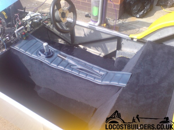

Paul TigerB6
posted on 24/4/08 at 02:01 PM |
quote: Originally posted by paulmw
I did all of the above and it looked poo. Most of the after market trims are too big and it is difficult to achieve a high standard finish with ali.
(but then my hands are made of sausages)
Mine was hidden under the carpet (the Supercat - not the BEC which deffo wont be getting heavy carpets!!) so guess it depends what you have to finish
the tunnel with. Mine looks like this anyway and took under 30 mins to do.
