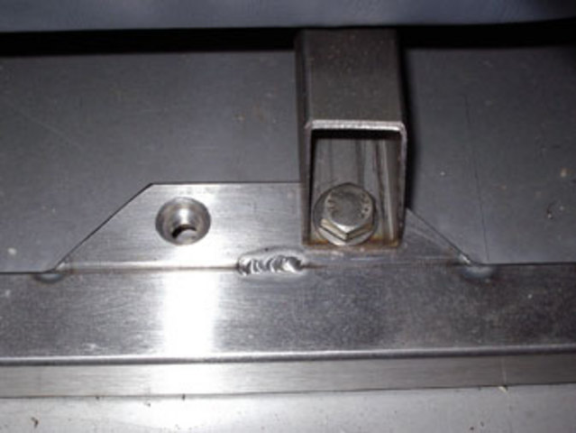

Don't know if this will help anyone, but I bolted box sections to the seats crossways, then welded short box sections (in four places) to the
chassis with captive nuts in them. I used an extra set of nuts so I can move the seat forward in case a shorter person (I think thats the polite term)
wants to drive it.
See pickie.
I'm just too tight to buy runners.

type 907
| posted on 2/1/04 at 12:25 AM |
Just realized that one pickie dosn't show it all.
