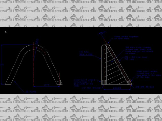

Thinking about the roll-hoop assy.
I'm going to have a stainless plate with a T45 hoop welded onto it. Can anyone suggest a thickness for the plate and a wall thickness for the
hoop?
The plate will be fitted using 8 bolts (yellow dots) and 2 harness bolts (red dots).
You have may of already mentioned it, but is there any bracing of any sort? If not or it's not possible, how about running the main hoop legs
through the plate and brace them lower down on the vertical

You mean solid aluminium hard-points/plates sandwiched between the CF, hopefully? Honeycomb isn't strong enough to bolt anything to!?
The other solution is to use threaded 'top hat' inserts that are screwed-and-bonded into one another from either side of the honeycomb
panel, allowing you to bolt on steel brackets/flitch plates. The advantage here is that you can add them later (if you know what you're doing
and ensure that the loads are spread across a sufficient skin area on the panel), whereas moulded-in hardpoints obviously have to be moulded in at the
outset. This pic shows an example (actually a front suspension mounting bracket, but you get the idea):
Rather than using a big, flat steel plate to mount your roll bars and harness to, as you show on your photographs above, you'd be better using
smaller angled plates that wrap around the corners of the monocoque; that way, no matter what the direction of the loading, you'll ensure that
it is fed into the carbon fibre skin in shear (good) rather than tension/compression (bad). The photo below should hopefully illustrate what I mean.
1/8" thick steel should be more than adequate if you design it correctly, though the roll bar on the car in the photo is actually aluminium, for
lightness:

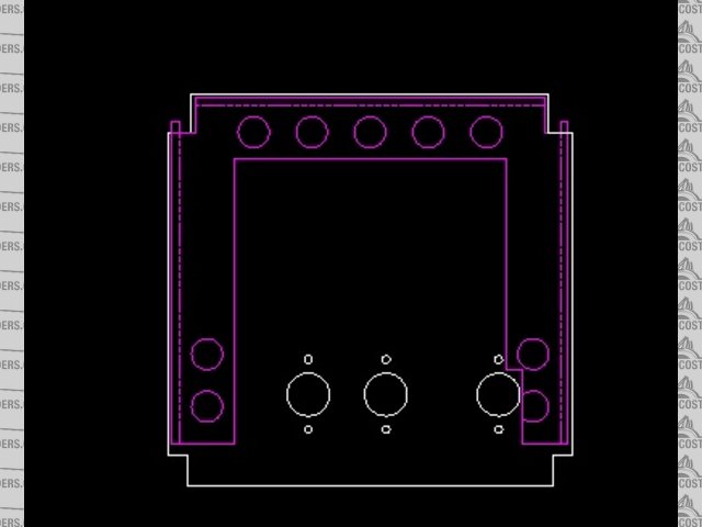

| posted on 19/7/11 at 06:28 AM |
Cheers fellas.
I'll take some screen shots of the cad drawings showing the hard points. IIRC, they are 'L' shaped to connect vertical faces to
horizontal faces.
It's Evolution Baby!

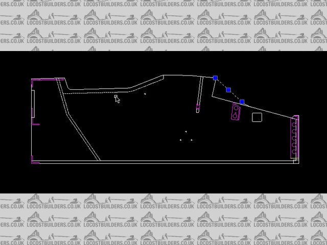

| posted on 19/7/11 at 06:49 AM |
CHASSIS CAD DRAWING - SIDE PROFILE
Inserts are in purple...

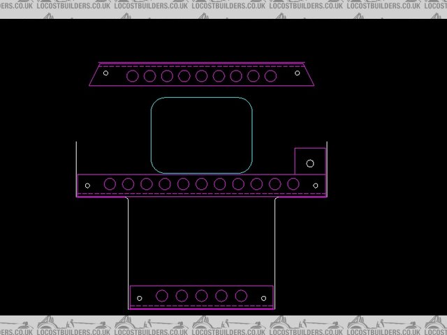

| posted on 19/7/11 at 06:52 AM |
CHASSIS CAD DRAWING - REAR BULKHEAD

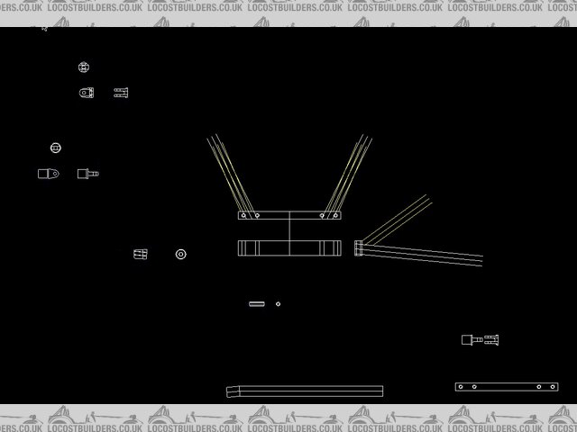

DRAWINGS OF MOUNTING HARDWARE
Mainly clevis style...
ENGINE AS HUNG ON ORIGINAL FORMULA VEE

| posted on 19/7/11 at 07:03 AM |
CAD DRAWING OF ROLL-HOOP
This was the roll-hoop as used on the race car. It was approved by the regulatory body. Note that it bolts directly onto the chassis from underneath
the top-chassis panel.

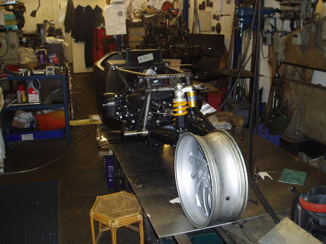

| posted on 8/10/11 at 10:19 PM |
Latest progress:
HowardB
| posted on 9/10/11 at 05:02 AM |
wow! Would the bmw engine make a good BEC?
Howard

Some nice, fabrication there cant weight to see the progress.

| posted on 10/10/11 at 07:54 AM |
I must say it's looking very good there mister
