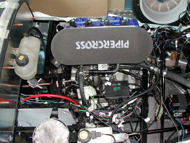

Jasper
posted on 18/4/03 at 09:38 AM |
Here's the new pipercross filter all fitted with Dynojet kit, very happy.... now let's hope she starts. BTW MK9R, all the jets were
beautifully clean, one less thing to worry about.
Thanks Andy, this is the only thing that would have fitted, and it still touches the bonnet at one end. I couldn't even use the plastic backplate
that the trumpets sit on, I got rid of this to give myself those extra few mm, and bolted the ali plate straight to the carbs - lots of fettling need
to make it fit flat tho'.

andyd
posted on 18/4/03 at 10:11 AM |
Nice one Jasper.
Sorry I didn't actually get the photos on the site for you but you seem to have made the right choice anyway.

Rorty
posted on 19/4/03 at 01:34 AM |
Jasper, I'm not too familiar with the ZX9 setup, but when you describe excluding the plastic back plate the trumpits sit on, does this mean
you've also excluded the trumpets?
The trumpets are a very critical part of the system, and omitting them would result in the engine not running correctly, if at all.
Just a thought, but I'm sure you're ahead of me.
Cheers, Rorty.
Jasper
posted on 19/4/03 at 09:33 AM |
No, I've bolted the trumpets directly thro the ali plate into the carbs. Thanks for keeping a check tho' always appreciate - I have been
known to do some daft things!
