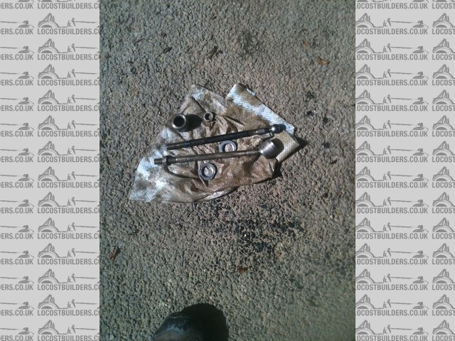

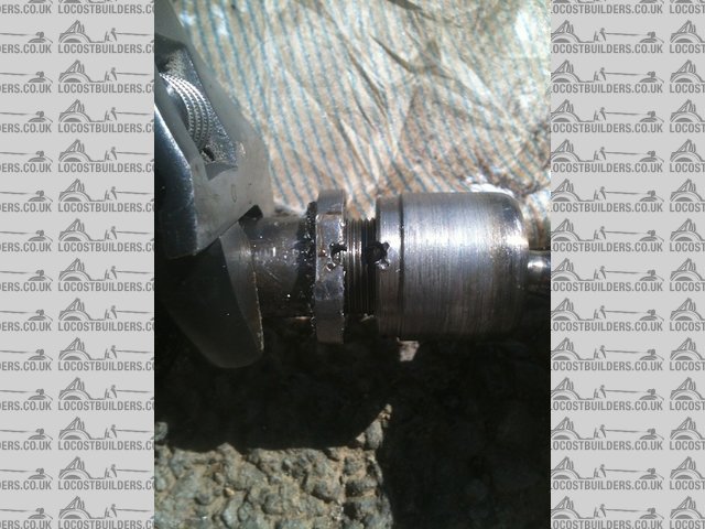

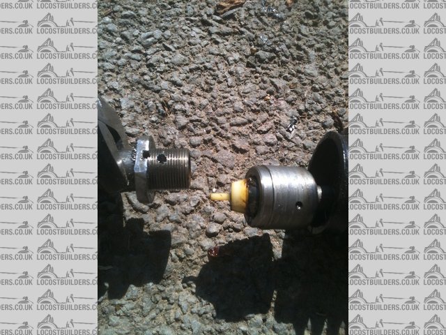

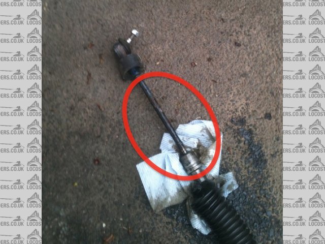

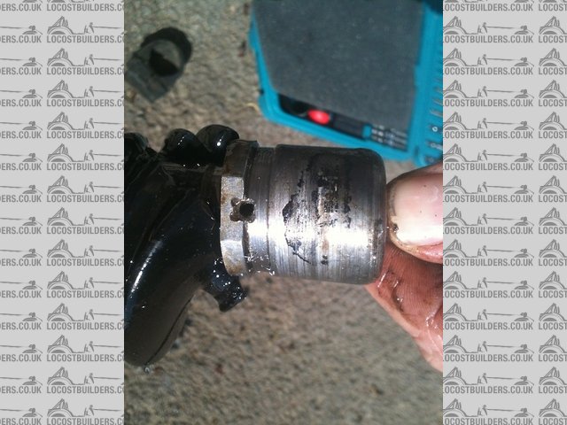

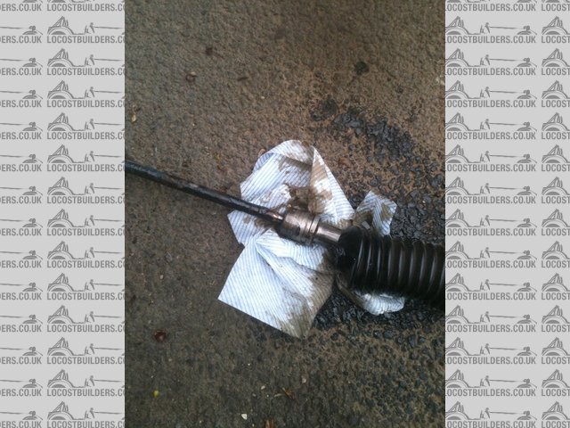

posted on 3/5/12 at 05:13 PM |
All done...
Pin Drilled -
Separated...
Apart...
Et voila...
It's Evolution Baby!
