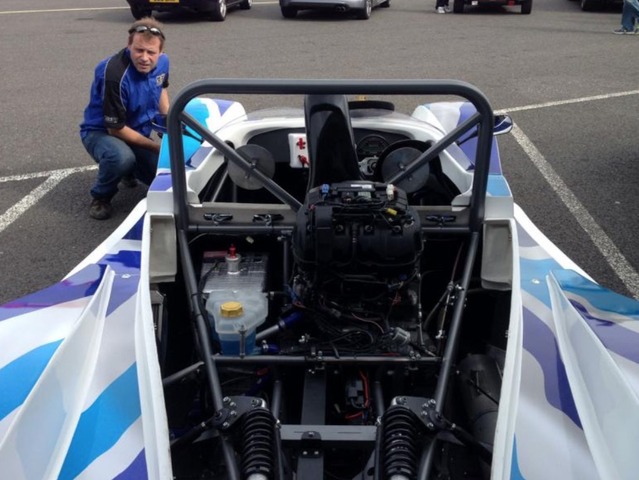

I'd imagine if I did go for a bespoke system, then my head would suggest the Radical way of doing things - 2 headers coming round either side of the heads and merging above the gearbox.
Oh man, my memory - here's me talking about Radicals and then I remember that you had already done a successful midi design with the Sabre! How did you package its exhaust?
I had a quick peek at Google images, but could only find this shot of the Sabre rump... I've found Wally quicker!

Hi Scootz
My pleasure fella - On sabre we bring the pipes out on one side altogether
Several reasons for this
1 - I’ve worked on plenty Radicals and get pissed off burning myself on the headers which
Are right where you want to work most of the time 😀
2. CBR1000rr primaries are short, real short and so if building to tuned length you will be stretching the pipes to much to get either side of head and back in again within the optimum pipe length
3 - bringing the pipes over the top tends to subject some really sensitive parts to a lot of heat - TB’s Airbox, sensors, loom etc
I will see if I have a picture of sabre system for you - if not I will take some in the morning
