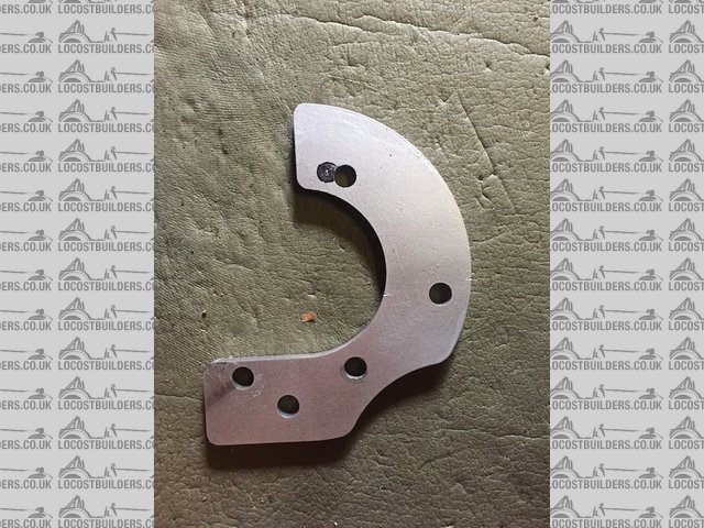

I've had some brackets laser cut to mount MX5 rear calipers to sierra rear hubs, these clear my 13inch wheels with plenty of space and use fiesta
Mk1/2 221mm front disks.
I had these cut for myself but it was the same price for two for me or 28, so I got 28 made! I'm not looking to make any money really just seems
a shame for them to sit on my garage floor when others could use them.
I wont lie - they're a b****r to fit as the caliper carrier bolts sit between the bracket and where it mounts to the sierra hub so you need to
put disk and caliper on together, it's not a problem but you really need 3 hands! (Or two hands and a lot of swearing like I just did!)
You do have to grind a little away from the back of the caliper carrier, about 1mm or so, also I'm running the calipers upside down so that
it's a better route for the handbrake cable - makes caliper bleeding more difficult. They will mount the right way round on the bracket if you
want.
£10 per pair + P+P, I'll also be at Stonleigh (Sun) so save on the P+P if you want

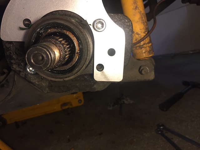

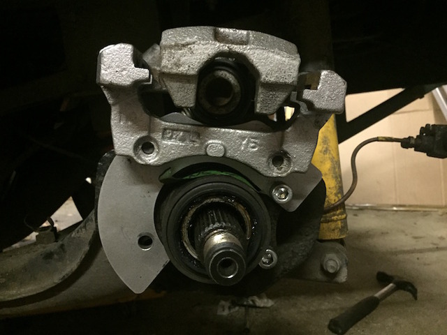

I'm slowly moving forward, however need a sanity check. The n lining the plates up I can't seem to h
get the three hum bolts to line up. Pictures below show what I mean (and yes I know the adaptor plate bolts on to the outside, the picture with it
sandwiched between the hub carrier and the suspension was just so I could make where the new hole should go)
and
So do I drill another hole as below (black dot) or am I missing something aka being thick?
try fitting it the other way up. I seem to remember that the sierra hub carriers don't have equidistantly spaced bolts. The distance between the bolts on each of the long sides of the "rectangle" that they form is different.
I'd tried it left and right but not upside down. I'll have another bash this weekend. I did try lining it up with the wrong holes so that
the caliper would have sat at 12 o'clock which would have been perfect, apart from being to tight on the disk...
Chris

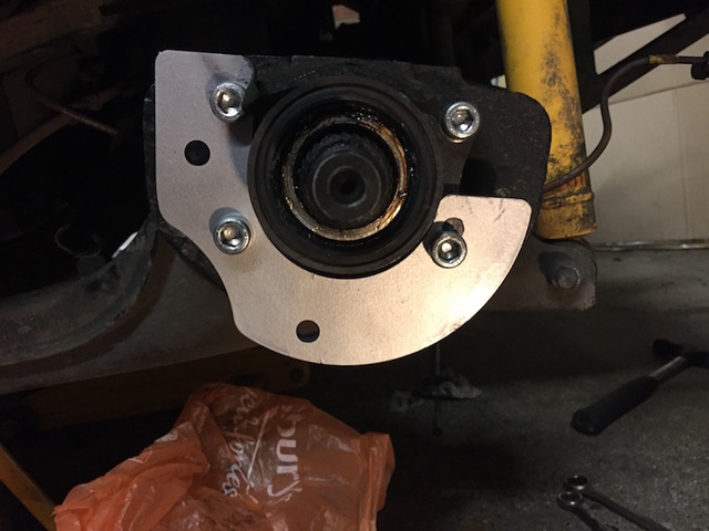

Managed to get out to the garage and low and behold the plate fits, but it's upside down and positions the calliper right next to a large bit of
the suspension, so it'll never fit there. Interestingly as my Tiger uses most of the back end from a sierra it looks like your hubs are upside
down :-0 ! So I think I'm going to re-drill the plates with the brake calliper at 12 o'clock as that's the best position for them
(unless anyones got some bright ideas?). At least I'm not going mad!

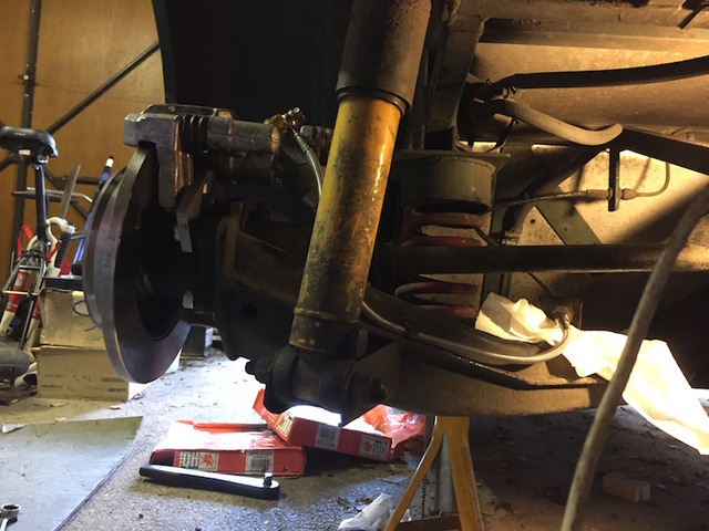

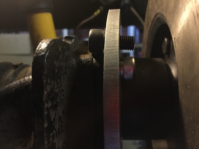

Few pic's for those that are interested:
and clearance (Clarence)
Chris

So this is the [position I'm going for, bit of fettling and drilling required. Next step is to put the hubs back on so I can check the
clearance.
Keep me posted - I'm keen to see this work.

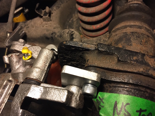

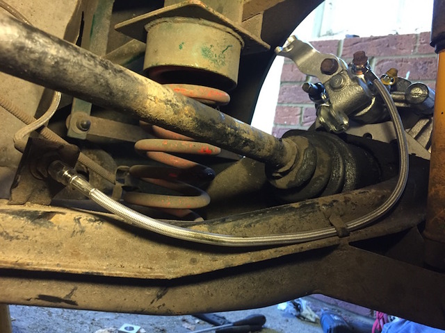

A little update, so I've persevered on, had some fun getting bolts to fit, a few 'being thick' moments and a bit of judicious use of
the angry grinder I've got the brake to a point where I've attached the hoses (cheers to Russbost).
Now just need to fit the pads, bleed and finish the hand brake :-)
Bolt location that need a bit of work:
And they're in:
and
