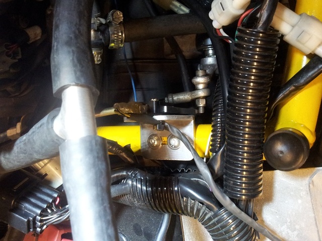

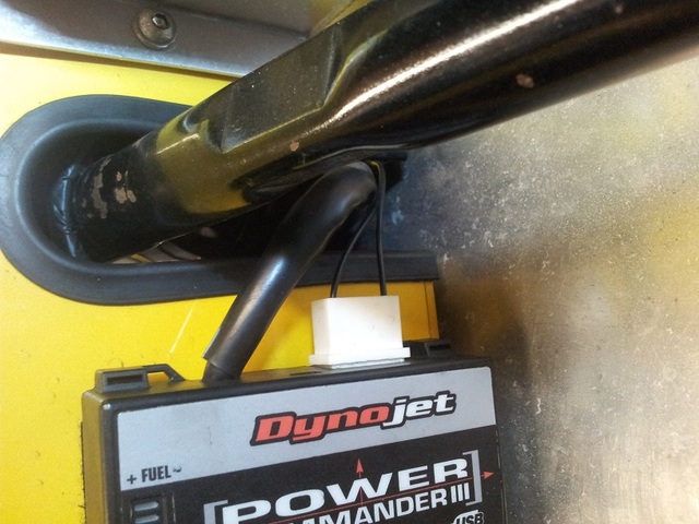

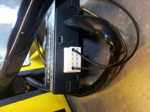

Ok, i've managed to get some pictures tonight of what i have done.
I fitted a slightly over long bolt through the gear lever arm on the engine end so it will press against the switch.
A bracket was made with a slotted fitting so that it can be adjusted back and forth.
The switch is bolted to the bracket so that it was in a position to be pressed by the over long bolt
Connect a length of wire to the switch, and then back to the power commander into the correct pins
Update the power commander with the quickshift software - you can find it online if you look in the right places
Take it for a run to test that it works
Adjust the location of the switch until it works at the right time
Bolt through gear lever, and switch:

Slot in bracket to allow adjustment:
![](/galpreviews/20130604_214509.jpg) ![Description](/gallery/20130604_214509.jpg) Description
Connected to power commander:
![](/galpreviews/20130604_214539.jpg) ![Description](/gallery/20130604_214539.jpg) Description
showing which pins to connect to:
![](/galpreviews/20130604_214602.jpg) ![Description](/gallery/20130604_214602.jpg) Description
Cost:
switch from Maplin: £2.89 http://www.maplin.co.uk/v3-style-alarm-tamperswitch-20406
Everything else i had kicking around in the garage:
Wire
Power commander plug: came supplied with power commander fitted with 9v battery connecter ( just remove the existing wires)
M5 Rivnuts to fit into chassis
M5 bolts for fitting bracket to chassis. M3 bolts for fitting switch to bracket
Bracket made from aluminium angle
