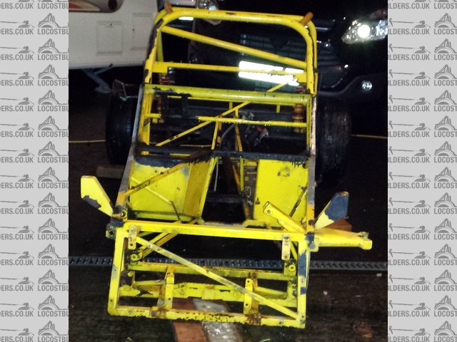

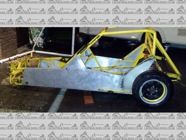

posted on 15/1/15 at 08:57 PM |
I got to a point today where I realised staring at the Striker wasn't helping. So I got stuck in!
![](/galpreviews/20150115_200432.jpg) ![Description](/gallery/20150115_200432.jpg) Description
![](/galpreviews/20150115_200506.jpg) ![Description](/gallery/20150115_200506.jpg) Description
I couldn't remove the nearside rocker as it appears to be seized to the through bolt? Will have another look tomorrow - pretty cold out there
tonight!
Dopdog
posted on 16/1/15 at 05:11 AM |
I would say that's more than stuck in ![](/images//smilies/bigsmile.gif)
