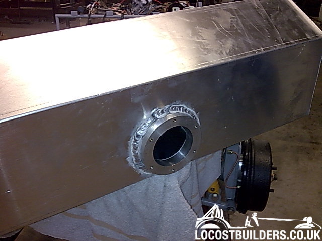

made my own for R1 pump.

welderman, is that up and running?
If so does it work ok? have you any baffles, any problem with starvation, I thought you would need a deeper sump to guarantee fuel? Did you make the bit for the pump to bolt to? I believe someone on here sells these?

welderman
posted on 8/9/08 at 03:03 PM Reply With Quote
Hi Andy, i made the tank myself and it works, has two baffle plates in and i bought the ally boss from MK Engineering, cant remember how much though. The R1 pump has its own littlr sump thingy too i was told so, yep works fine.
Cost me approx 70 quid for the ally sheet, then the boss?, then my time to weld it up(free).
Joe
