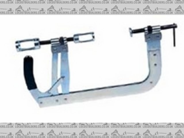

Pretty sure the Sykes Picavant 03950000 is what you want -- works on the Rover K and most 16 valve engines
http://www.toolsbypost.com/product.php?category=1284&id=1795
Machine Mart do a much cheaper one but I don't know if it has enough clearance
http://www.machinemart.co.uk/shop/product/details/cht461-ohc-valve-spring-compressor/path/automotive-tools
