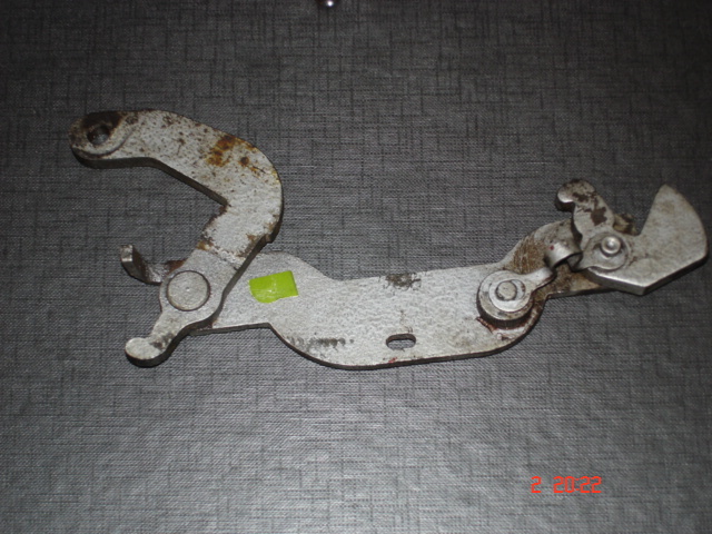

and below is mk2 escort, which looks different to yours - I post a photo so that you know what to not get, maybe compatible but I doubt
it.

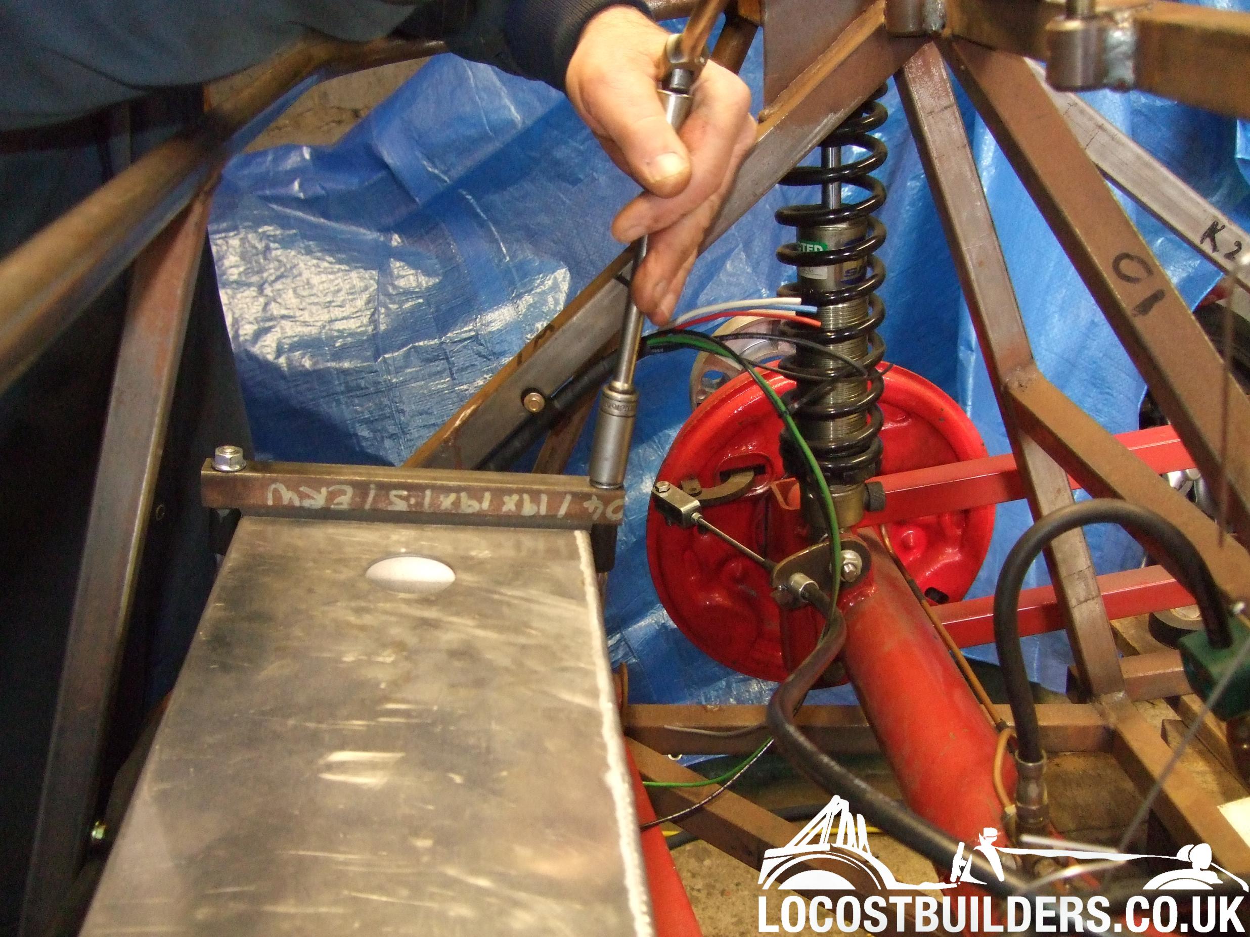

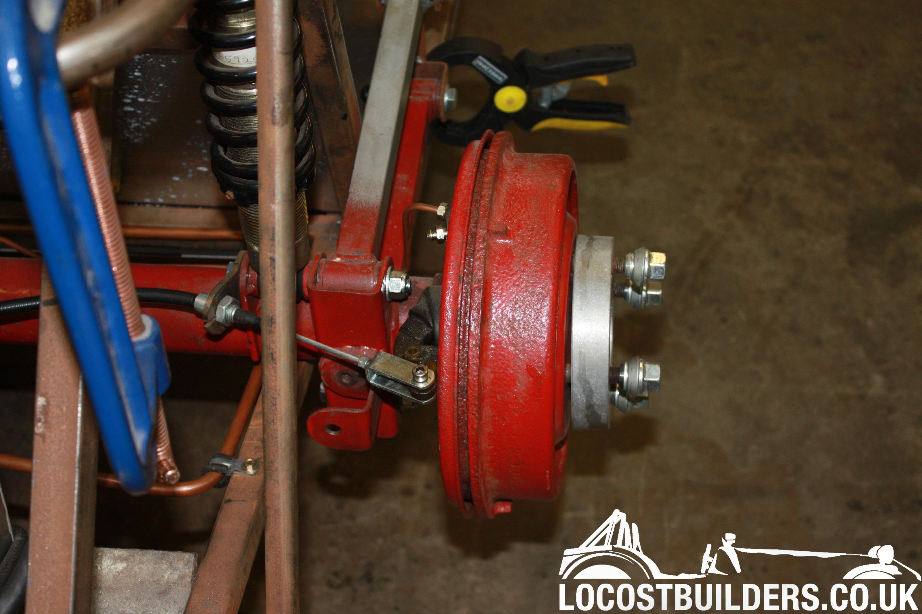

| posted on 16/8/09 at 10:03 AM |
If the only problem is the location of the lever it's not a big job to rotate the back plate to a better position and then re-bore the mounting
holes in the back plate.
Davie
daviep
| posted on 16/8/09 at 10:07 AM |
Here's a pic of mine, sorry it's not the best picture but it's all I can find at the minute.

daviep
| posted on 23/8/09 at 02:40 PM |
Sorry forgot to check this thread for a few days.
Standby while I get pictures from the missus she's the official photographer
To rotate the backplates I removed the four halfshaft retaining bolts and partially withdrew the bearing. The backplate is a good fit over the
bearing and is held central to the axle. It's then just a simple matter of roatating the backplate to the desired position and re-marking
through the bolt holes in the axle casing.
I'll look pics out as soon as the missus finishes making chutney
Davie
daviep
| posted on 23/8/09 at 03:29 PM |
Couple of pics now uploaded to archive.
NSR
OSR
Bracket
