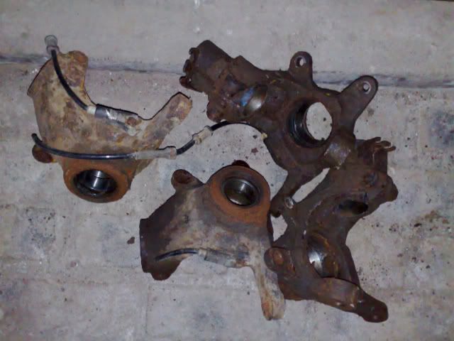

but I do have a set of rusty front calipers (same as sierra's with ABS) which would do as exchange ones
oh, and I've got the granada uprights without the hubs too (but I doubt they are any good to you)
