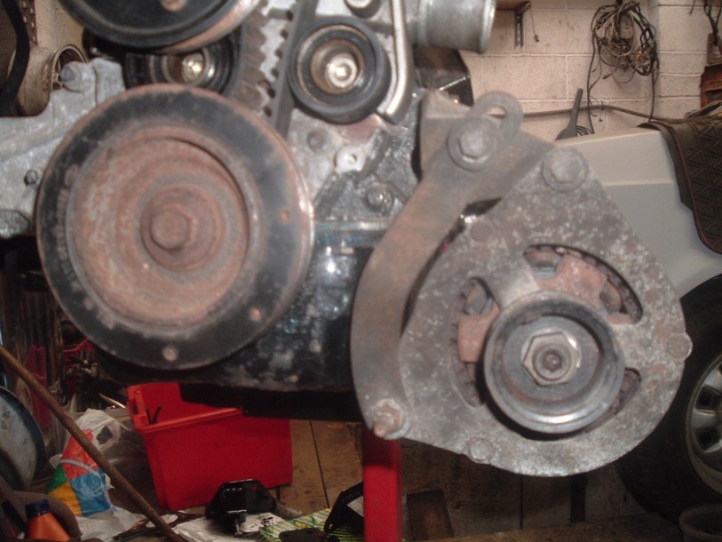

A poster on turbosports tells me this is what I need;
like this
and from the front;
Does anybody have anything like this ?
Regards
Jon

Thats cvh not zetec.
Will your chassis give you that sort of clearance ?
It wouldnt in a locost.
[Edited on 8/8/11 by big_wasa]

Good point Warren, it is a Westfield chassis. I will need to measure it.

Difficult to tell as it's black on a dark background, but I'd say that's XR3. I've got one somewhere... Would take a bit of 'finding'.

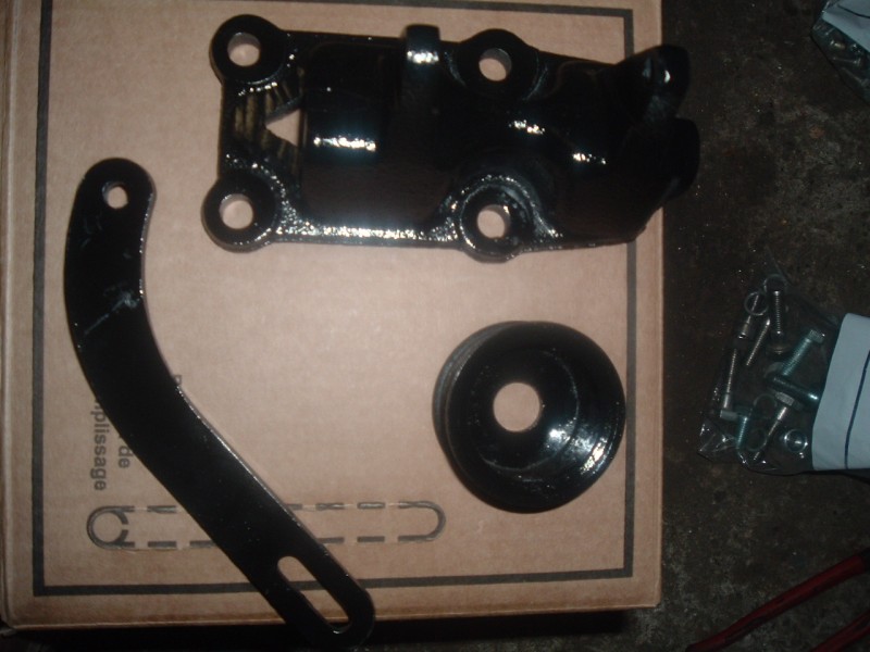

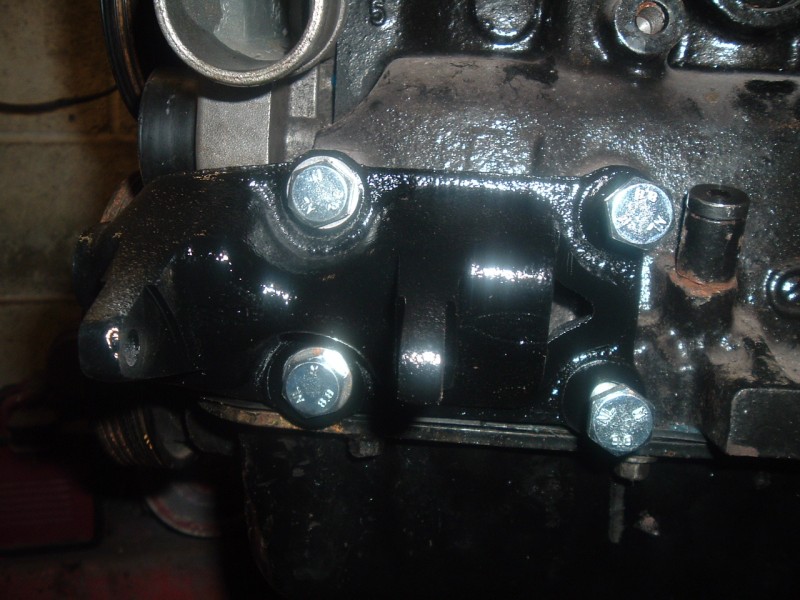

Thanks for the effort guys. I have been told this is what I need, but it may require a little alteration, depending on engine mounts;
If this will fit I should be ok as I have not made/sourced engine mounts as yet.
