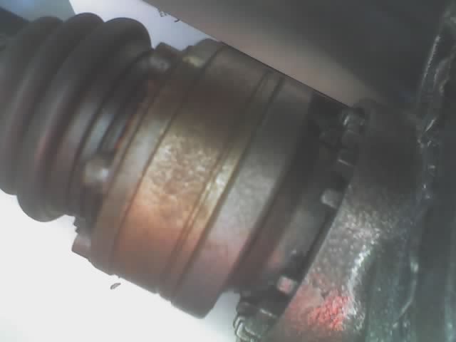

I understand that this is what I need to check (lobro cv joint)
  cv joint

BTW Both ours should have the above joints.
