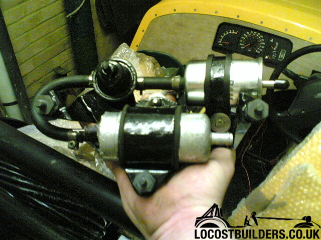

Cavaliers also have a nice pump & mounting bracket that also mounts a pressure control valve (adjustable) and filter.

Yes they have a fuel return on the injection engines, it comes off the fuel rail just at the vacuum controlled presure regulator. Why Vauxhall fitted
a mechanically (2 spanners required) adjustable regulator (£80) in between the pump and the filter I have no idea, but they did.
